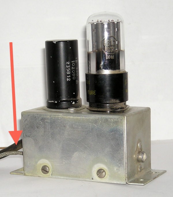

can anybody advise me please

MessagePosté le: Mar 22 Juin - 15:59 (2010)    Sujet du message: GE Valve phono amp Répondre en citant
it has no transformer ? is it designed to run from the transformer on the valve amplifier that you use it with  hats off
MessagePosté le: Mar 22 Juin - 16:07 (2010)    Sujet du message: GE Valve phono amp Répondre en citant
Paul,
What is this big black wire Question
I assume this pre works kind of like the Leak preamplifier that takes it's power from the amplifier.

MessagePosté le: Mar 22 Juin - 17:28 (2010)    Sujet du message: GE Valve phono amp Répondre en citant
Salut
yes the black cable is for power , and yes I think it feeds power from the amp ...... 3 core american 60s cable, plug is like the plug you use on Tannoy speakers a 4 pin plug . I hope I can run it from my Pye Mozart 10 hf Mono amp  Rolling Eyes   what is confusing me is why is it 3 core ? any other american equipment I have ever seen the mains cable was 2 core

MessagePosté le: Mar 22 Juin - 18:18 (2010)    Sujet du message: GE Valve phono amp Répondre en citant
monobuddie a écrit:
Salut
Ground, of-cause!  Wink

MessagePosté le: Mar 22 Juin - 19:29 (2010)    Sujet du message: GE Valve phono amp Répondre en citant
Rap
yes you would think so but I have never seen earth/ground used before on american stuff form the 60s ? I dont think it is ground will have to do some tests  whew
MessagePosté le: Mar 22 Juin - 20:48 (2010)    Sujet du message: GE Valve phono amp Répondre en citant
monobuddie a écrit:
Salut
Paul, I think that those three wires inside the black cable are: +B voltage (anode voltage), filament voltage and ground.
As you said, "is it designed to run from the transformer on the valve amplifier that you use it with". (imho, of course).
You should see that one of those wires is directly connected to the tube socket (filament, pin 7 or 8), another to a resistor which in turn goes to the socket (anode, 2 or 5 - the valve looks like a 6SC7, a double triode) and the third wire to the chassis ground.

MessagePosté le: Mar 22 Juin - 21:09 (2010)    Sujet du message: GE Valve phono amp Répondre en citant
Piero  hats off
Sorry I have checked there are 4 wires !! one is black[ground] one is red ? and 2 brown cables ?
the valve is 6SL7
it is designed to work on 110v ? can this be used on the transformer on my 230v amp ?
thanks for your help will check out the pin connections  bow
MessagePosté le: Mar 22 Juin - 21:23 (2010)    Sujet du message: GE Valve phono amp Répondre en citant
monobuddie a écrit:
Piero  hats off
the valve is 6SL7
Right, it's a 6SL7, I just gave a better glance at the picture... (by the way the 6SC7 is a metal tube, never seen a glass variety...)
Well, those two brown cables go to the filament (pins 7 & 8 on the valve socket), I guess.
Anyway, your pre is designed to be operated from a source of DC voltage (the red wire, I suppose around 100-150V) and 6.3V (ac or dc, dc would be better - in theory...) for the filament. That is, nothing to do with the mains line voltage.
I suppose you could pick these voltages from your amp... just a little work with a solder gun.

MessagePosté le: Mar 22 Juin - 21:34 (2010)    Sujet du message: GE Valve phono amp Répondre en citant
 thank you  bow
A good technician could make this work ?  so it is not a waste of money  Smile
I have another GE amp with the metal tube , i like the sound for 78s
MessagePosté le: Mar 22 Juin - 21:50 (2010)    Sujet du message: GE Valve phono amp Répondre en citant
Surely, it's not a difficult task.... by the way, another solution could also be a small power supply.
Well, you know.. it's a hobby Wink
... with the 6SC7 ! Smile

MessagePosté le: Mar 22 Juin - 21:57 (2010)    Sujet du message: GE Valve phono amp Répondre en citant
would a power supply be easy to build ?
that sounds like a good idea  hats off
MessagePosté le: Mar 22 Juin - 22:06 (2010)    Sujet du message: GE Valve phono amp Répondre en citant
Most difficult things are: find out a small transformer and a good looking case... circuitation is quite simple, and could be just copied from the power supply section of your other GE preamp.
