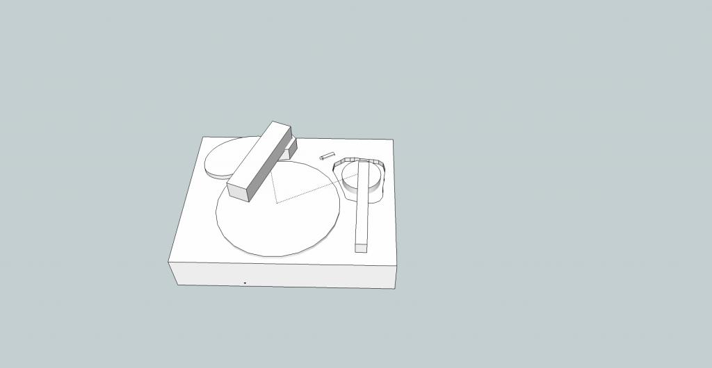

Here is the concept for my turntable:

The Lenco will be rotated 90º counter clockwise. The TransFi Terminator tonearm will be mounted at 12:00, the on/off switch will be at ~1:00, and the Pioneer PA-70 tonearm will be mounted ~2:00. Both mounting points should be well clear of the motor, so I shouldn't have any hum issues. And both tonearms have interchangeable heads so it will be relatively easy to switch between my various cartridges.

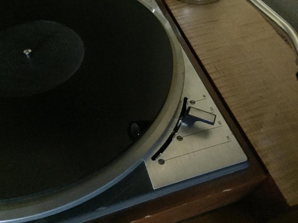

Received a new bit in the post Friday--a speed selector switch knob:
I've pretty much decided to go the bentonite/resin approach, but still need to work out the mold and design.  I have one more bit to receive (bearing parts from Jolly) and I'll have no more excuses for not starting Wink

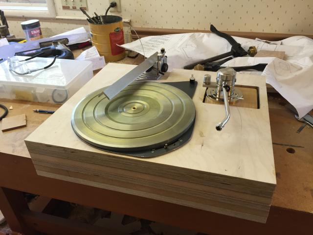

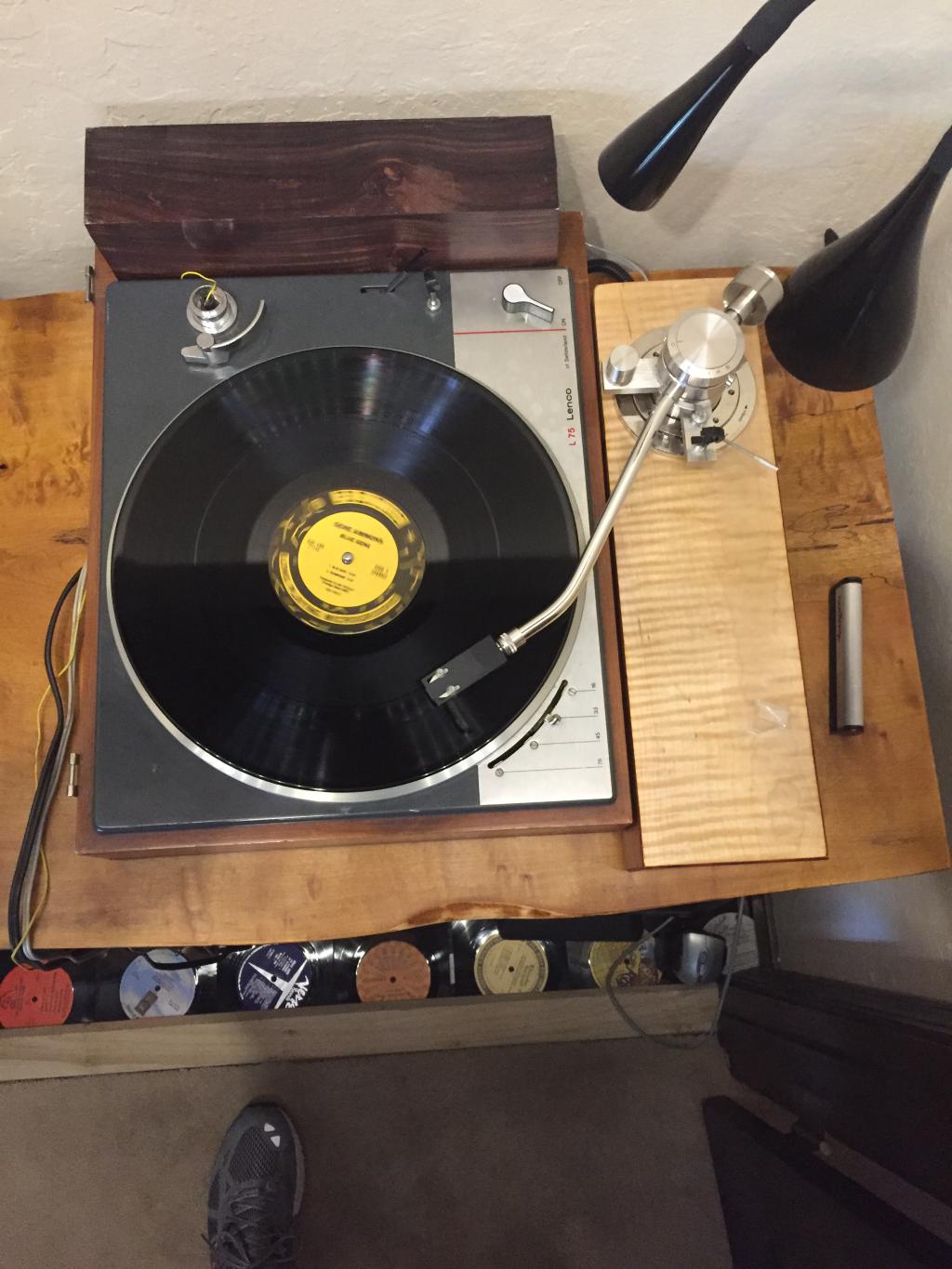

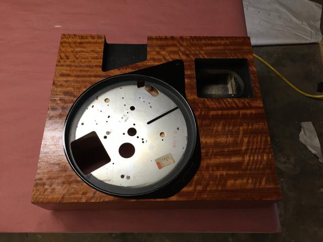

The plinth construction is done and I'm well into finishing the platter and plinth.
Bay Area, CA, USA
MessagePosté le: Dim 25 Sep - 20:31 (2016)    Sujet du message: Dipping my toe into the Lenco Water... Répondre en citant
It looks great !How did you manage to stick the wooden cladding (not sure of the term ...) on the plinth ? This is usually considered as a tricky job !
Impatient for further progress  bravo  !
Good Luce !

MessagePosté le: Dim 25 Sep - 23:59 (2016)    Sujet du message: Dipping my toe into the Lenco Water... Répondre en citant
Good Luce !
Herve',
I used raw veneer from this shop:
http://www.veneersupplies.com/categories/Veneering__Supplies/Tools__%26__Supplies/
They have all the supplies necessary, as well as very helpful tutorials on the process.  I used a "hot glue" method where the glue was applied to the back of the veneer and the plinth with a glue roller.  After it dried for about 20 minutes, the veneer is placed onto the plinth and a clothes iron on "cotton" setting is used to activate the glue.  I then used a laminate trimming router bit to trim the edges.
