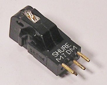

Sur ma Lenco j'ai cette Shure M7 MD.
Je ne trouve pas une pointe seule bien sur et j'envisage un changement de cellule.
Le porte cellule n'est pas standart.
L'ergot de montage du porte cellule sur le bras est en bas, alors que maintenant cet ergot est en haut.
Quelle serait la solution sachant que la platine est une B60.

Le problème du porte cellule n'est pas seulement la position de l'ergot mais le fait que les cellules dont la géométrie diffère des Shure, Stanton et Pickering ne seront pas correctement alignées.
Pour l'ergot, même si il était en haut, ça ne résoudrait rien car le type de baïonnette est spécifique à ce bras et porte cellule.
Pour ce qui est de la cellule, si tu comprends l'anglais, patiente un peu et Richard saura t'en dire plus.

The automatic translation method that I use has been more difficult than usual regarding this cartridge!
The Shure M7 is virtually the same as the M3. Three styli were available for this cartridge body: the N3, N7, and N21. They were the same stereo conical size and differed in their compliance and therefore, their performance. This was the first successful consumer stereo cartridge. Some people still enjoy its sound.
Shure continued to make one of these needles well into the 1980s. Compared with all Stantons and Pickerings, the Ortofons that I know, and Shure's later models, it's more difficult to replace needles in your Shure. As you have discovered, it is not easy to find good replacement styli for it. A few years ago, I sold two aftermarket (non-Shure) M3 styli to a fellow named Woody in Scotland. These styli were made by a long-defunct American company named TAE. They looked very good to me (note: I am not endorsing other TAE magnetic needles). And Woody didn't complain about them, so I assume that my evaluation was correct.
In short: this is a needle design that is not difficult for an aftermarket manufacturer to duplicate. Whether they will make decent imitations is another matter, however.
My own preference would be to change to a different, more practical cartridge. For your B60, the M7's performance is a good match. As a general rule, I would use a cartridge/stylus that is intended for use in ordinary record changers or ordinary disco use, probably around 3 grams pressure. So, Audio-Technica, Ortofon, and Stanton will have decent cartridges for you.
To go along with your Lenco, Stanton and Ortofon will have 78rpm styli. These can be easily and quickly changed. I've found that AT styli can be easily destroyed when they are replaced.

Richard, merci de ta reponse.
La traduction automatique de ton message me dit de changer la cellule.
J'hesite entre 3 modeles:
Shure SC35C
Ortofon OM-Pro
Audio-Technica-AT-95E
Montage de la Shure avec des vis plus longues que celles pour la M7 MD  ?
L'ortofon me semble un peu trop haute ? Probleme: reglage de la  hauteur du bras ?
L'audio Technica se monterait sans probleme.
Laquelle des 3 ou bien un autre modele ?
Je ne suis sur de rien et je fais encore appelle a vos connaissances.
Ma platine : Lenco B60.
La cellule Shure M7 MD
@+ et bonne journee.

What I don't know is what types of records you want to play on your Lenco. This would affect my recommendation of a cartridge.
Also, the last time that I worked on a B60 was during the early 1980s! I repaired a few of them, including the tone arms. Unfortunately, I forgot how the arms were designed. You will have to get information about height adjustment from someone other than me.
The Stanton 500 is a very low cartridge. In use, the arm should be level. If it tilts downward, the stylus rake angle will be excessive and you'll hear intermodulation distortion. The arm tube should be level when a record is played. Therefore, if you install this cartridge and the arm slopes downward toward the front, you can shim the cartirdge with pieces of plastic.
The 500 is identical to the Pickering V15 models (no longer marketed) and the "N" models. Good needles are available from Stanton dealers. I believe that I have one genuine mono LP needle that I can sell for this cartridge.
These cartridges can be had used on eBay very cheaply. My advice is to either buy a current "high-performance" DJ version of it, or to buy a used body and get needles one-at-a-time as you please. I believe that this will make an excellent match for your turntable, and with the former range of needles that still turn up, you will have great versatility and decent sound, too.
I also do not have much personal experience with Ortofon: they have not been as affordable here as the American brands and AT. However, Ortofon has long impressed me with their dedication to a wide range of record types, the way that Stanton used to be. Thus, Ortofon has seemed to be the only company that's left who are both practical and serious about record playback.
If your turntable was mine, I'd sell the Shure M7. It isn't as easy to replace the needles (nor to find them, although I know that they are out there). The M7 is not versatile.
Audio Technica doesn't permit a person to change from one stylus to another quickly, easily, and safely. Nor have they ever provided any specialty styli (such as 78rpm or styli for early mono records). I have an entire collection of broken AT needles (including new ones!). I need needles that are more rugged than that!

I know who the seller is. This needle may be worth buying. Since he claims that its tracking force range is 1.5--2.5 grams, I will guess that it will work nicely in the Lenco B60 at 2.25 grams.
However, if you want to also play 78RPM records, I would recommend using a different cartridge that allows you to change to the correct stylus easily. This is why I asked about what types of records you want to use.

Sauf cas extrêmes, une cellule ne vieillit pas, donc il te suffirait de changer le diamant.
Maintenant, est-ce que les performances de cette cellule, à l'échelle des exigences actuelles, sont à la hauteur Question wondering
Une maison sérieuse pour des diamants de remplacement: Arrow JICO.

François is correct in everything that he has said. F. also has gone throgh the recent pain of buying at least two badly-made aftermarket styli, whereas I went through this myself during the 1980s. However, the cost to me was quite low at the time, so I was able to learn from the experience about how these things are actually made. Coincidentally, the needle company in question actually had moved to my own city; thus, I was able to go there and interact with the ower. In the process, I picked up a bit of knowledge about the aftermarket stylus business.
Now that I know what kinds of records you want to play, I don't see much reason why you should not get a new needle for your Shure cartridge except that using a later generation of pickup will allow you to change needles more easily.
Your concern about hardened elastomer rubber in the needle's suspension is valid. However, this depends upon the rubber that was used as well as the way that the stylus was stored and what it was exposed to. A stylus manufacturer will not always use the same rubber for two different needles. I have two genuine identical styli for the Pickering "Phase IV" series cartridge. One works nicely; the other is as compliant as a piece of wood. They were both stored at the same aftermarket needle warehouse in intense Florida heat. I have no idea why one is good and the other bad.
Back to your own situation: here is what this boils down to: if you use your Shure M3/M7 (etc.), you will have the authentic sound of stereo in 1959. If you replace it with a Stanton disco cartridge, you will have improved performance at low cost and will be able to replace your needles easily with original styli. An alternative is Ortofon, a company that makes sense, especially in Europe.

Donc je résume:
1 - je change ma pointe (merci François pour le lien) la semaine prochaine.
2 - je me trouve une nouvelle roue (en cours sur ebay).
Je garde sous le coude l'avis de Richard pour une cellule Stanton si le point 1 ne me donne pas satisfaction.
