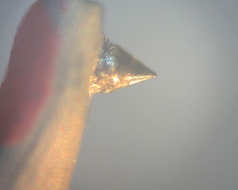

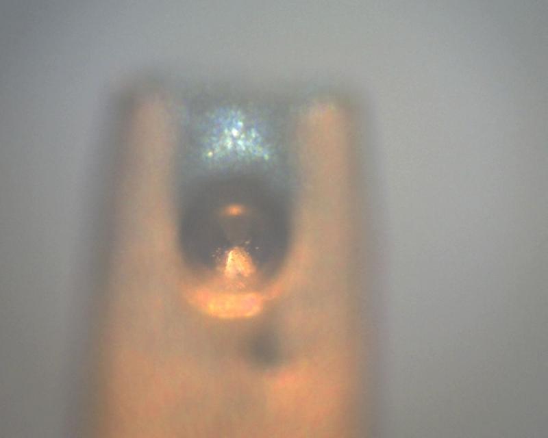

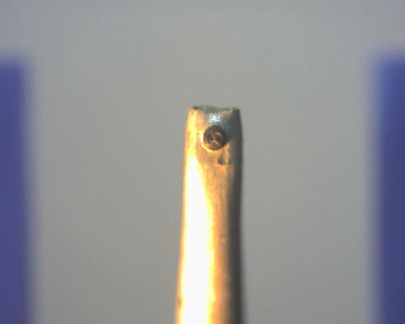

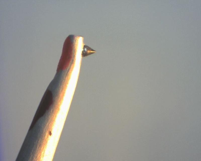

Crying or Very sad   en voici les preuves par microscope :
Le profil (vu d'en haut) est d'une pointe elliptique. Comparée à la pointe ATN120E qui est .3x.7 celle-ci est plus grosse, donc probablement .4x.7
Mais elle retire beaucoup de détail (mais moins que la DENON DL160!) et sonne fabuleusement bien, plus de corps, verve et impact. D'après mes recherches il s'agirait en fait d'un ancien système pro (broadcast et DJ) d'où sa compliance très basse <5. C'est peut-être cela, mariée au bras Jelco assez lourd, qui lui confère le caractère précis et autoritaire sans aller dans le roublard. J'applique 2g de VTF et cela suffit (on peut aller jusqu'à 4g).
Le vendeur au Canada me l'a envoyée au lieu de la AT125LC commandé au prix de 26 CAD. Je ne regrette pas à ce prix, et je l'utilise souvent pour les disques Rock et autres variétés. Pour ce genre de musique elle est très musicale et sonore.

I will confirm what you have observed about your stylus. The ATN-120E's dimensions are .4 x .7 mils (100 x 180, metric). And as you have reported, I think that this is a very good size for playing all forms of popular music, including rock. It gives an outstanding signal-noise ratio with this material. It is also a very good tip size for playing 45 rpm records, although for mono 45s, I prefer the rare 1.0 mil conical tip (25um).
Aftermarket stylus manufacturers/distributors had their own methods for classifying diamond tip sizes. Sometimes, their classfications were better than the systems used by original manufacturers. For example, the letter "Q" was probably used for all needles that were more sophisticated than the "E" (ellipticals). The reason for "Q" is that it stood for "quadraphonic." The best quadraphonic system used a radio-frequency signal to carry the rear channels, which required a specially-shaped diamond. Thus, the first elongated elliptical tip was developed for this purpose by a man named Shibata; his shape is sophisticated.
Note, however, that these systems do not distinguish between the ellipticals' tracing radii, and the differences between elliptical tip dimensions are quite audible. For example, a .3 x .7 tip is 50% wider than a .2 x .7 tip. And although the .2 x .7 was regarded for many years as the ultimate audiophile tip size, in general, I prefer the .3 x .7. Interestingly, among Stanton's products, for a long time, the "best" Stantons had the .2 x .7 tip, whereas the "best" Pickering tips were .3 x .7.
I've noticed that in many cases, the aftermarket stylus companies re-packaged geniune Audio Technica styli rather than made their own imitations. The reason for this was probably that AT gave them exceptional prices. I don't believe that this was the case with other brands, although it has been obvious to me that, for example, replacement needles for Grado, were beyond the means of the aftermarket companies to fabricate with any economy. This was probably the same for B&O.

- I liked your photos, although I could not make out the tip very well. The precision workmanship of the AT cantilever is admirable. The Japanese seem to excell at their micro-precision. However, this, in itself, does not give us a superb cartridge or one that is practical.
- The view of a stylus that's essential is head-on (or from the rear). This is the view that matters, and it doesn't even have to be a nice picture: my most useful image is a simple shadowgraph because it has the best contrast. It's also the view that's used at Expert Stylus. What have you been using for a microscope? I have been struggling with the Mattel/Intel computer microscope (now marketed under the name "Digital Blue").
