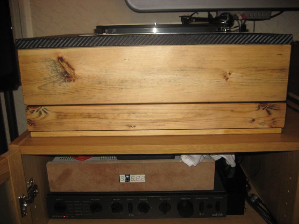

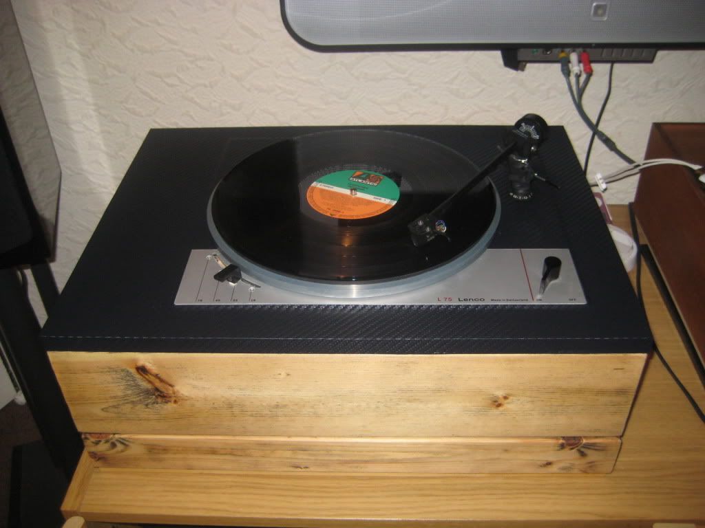

Almost complete:
Sorry about the quality of the pictures - room is quite dark, even with the lights on..

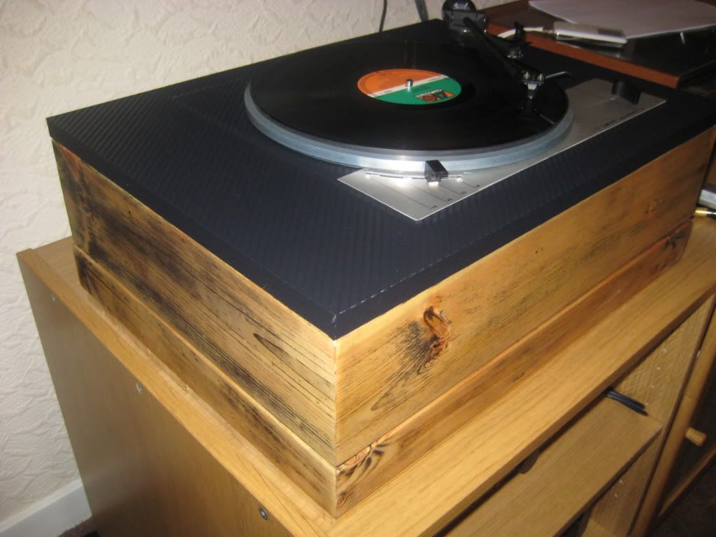

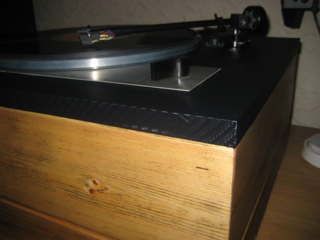

MessagePosté le: Mar 14 Déc - 12:06 (2010)    Sujet du message: L75 - Almost Finished! Répondre en citant
Hello Robert,
Yes, the top is made from MDF, which has been routed to let the top plate sink in to it.
Then covered with 3M carbon fibre vinyl (very stiff to work with, but when heated up, it goes like tissue paper....
The lower part is split into 2 - the bottom is made from pine and contains sand (round not sharp) and weighs around 17Kg.
The upper part is also from pine, but inside is layered using MDF and hardboard, weighs around 15Kg - all the wood came from my daughters old bed Mr. Green
Many thanks.
Andy
