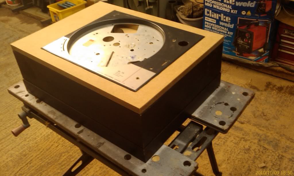

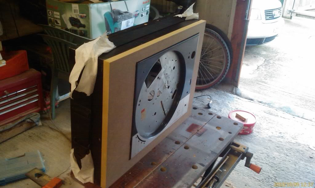

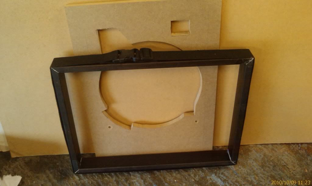

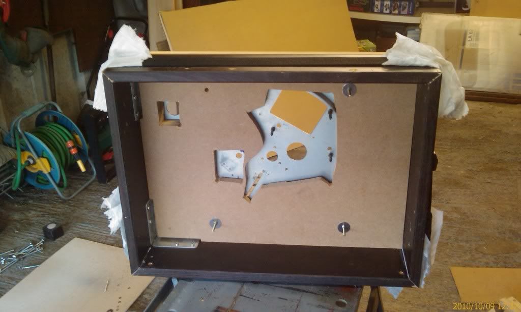

Just a few pictures of my latest build - nothing to exciting with this build though, that will happen with the next.
Using the top plate, motor and all the fixings from the normal L75, but removed all the arm related bits as I will be using a Linn Basik Plus.
The wood was from my daughters old bed cut to size and glued.
The smaller of the plinths will contain broken glass (I work for  a glass container manufacturer so I can get as much as I want for no cost) and act as extra mass and hopefully damping.

The main carcass-
The lower carcass -
Top plate and top of the plinth - test fits -
From below (up-skirt!!)-
Minus the top plate and filler wood -
The two plinths together with the filler wood inside -

Finish off the lower unit so that the glass can be placed inside.
Create feet for both.
Glue everything together.
Install all the hardware.

MessagePosté le: Ven 22 Oct - 12:04 (2010)    Sujet du message: New project Répondre en citant
Hi Andy,
You will fill the plinth with broken glass, correct Question
If I undestood it correctly, will you put broken glass in a resin Question
I wonder about the damping properties of glass though.....
Good luck with you project Okay

MessagePosté le: Ven 22 Oct - 12:23 (2010)    Sujet du message: New project Répondre en citant
Hi Andy,
HI Francis,
The main plinth will contain MDF and particle board glued and screwed to each other to fill the void.
The lower plinth (I suppose it isn't really a plinth) will be filled with silica (one of the few componants of making glass).
To begin with, I will leave it loose and see how it performs - then will look to put it in resin (perhaps build a second lower plinth for this).
